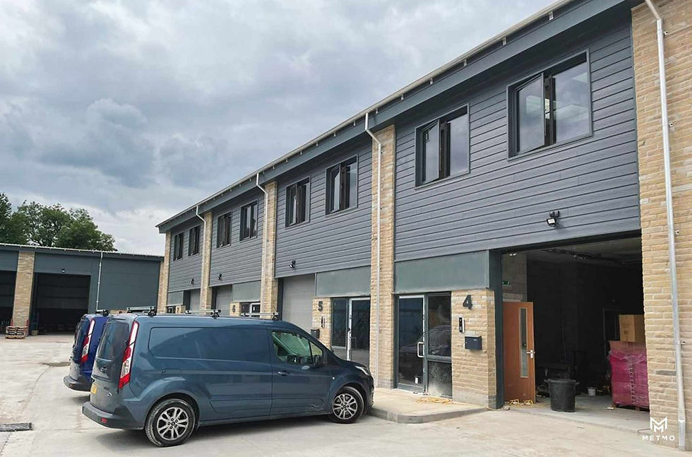

Premises upgrade
Just a little bit of general company progress for you, Over the past few years we have gone from working in my living room mocking things up in the shed, to a small office and workshop in the centre of Leeds, with an ever expanding storage space where the products are assembled and dispatched from a second location.
We have decided to move across town to a place where we can all be together with more space to design and build! It marks the progress we have made in 3 years with your help and support, so a huge thank you for your ongoing support for our small business, together we have built a team and a company that can really create freely and you are 100% a part of that and one that would not have been possible without the kickstarter platform. So a huge thank you for sticking with us!
A sneak peek at the new unit! on a sunny day in the UK...
And just as a side note the moving around is all within our schedule and will not affect any delivery timelines.
